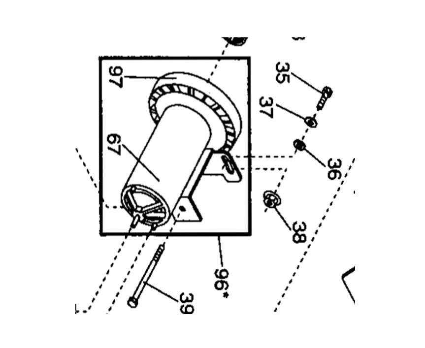

Motor Bracket Instructions
ATTACH BRACKET TO MOTOR WITH SCREWS PROVIDED
How to remove flywheel (97):
Turn the motor clockwise to loosen off the old shaft.
Spin the new motor shaft in a counter-clock wise direction, use pliers to lock in place.
