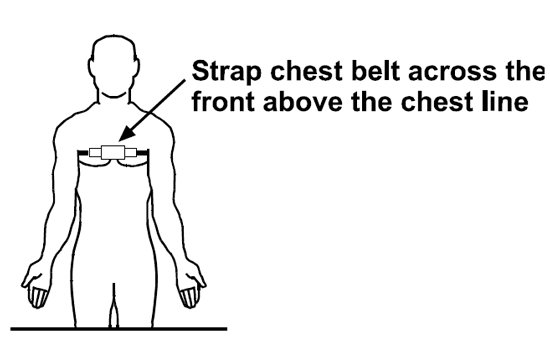

USING THE CHEST BELT HEART RATE MONITOR: For proper operation, the chest belt should be worn with the monitor strapped across the front of your body just above the chest line as shown in the drawing on the right. The monitor needs a little body heat and moisture in order to work properly. To ensure correct operation you may want to wet the two rubber pickups under the belt prior to exercising.

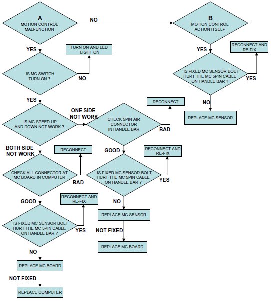

MOTION CONTROL:
Walking belt speed can be increased, decreased or stopped using the Motion Control sensors on the handlebars. To do this follow the instructions below:
NOTE: Photos may differ slightly from your treadmill.
1. Press the
MOTION CONTROL button on the console to switch the motion control function on and off:
When the LED light is ON, the MOTION CONTROL is active.
When the LED light is OFF, the MOTION CONTROL is off.
2.After switching on the MOTION CONTROL, wave your right hand approximately 6 inches above the motion sensor on the right handle bar to increase the speed. The sensor will sound one short BEEP per scan and speed up by 0.1 MPH per BEEP. Holding your right hand approximately 6 inches above the right sensor constantly results in the sensor sounding one long BEEP per second and speeding up by 0.5 MPH per second.
3.Wave you left hand approximately 6 inches above the motion sensor on the left handle bar to decrease the speed. The sensor will sound one short BEEP per scan and decrease speed by 0.1 MPH. Holding your left hand approximately 6 inches above the left sensor constantly results in the sensor sounding one long BEEP per second and decreasing speed by 0.5 MPH per second
4.Wave both hands approximately 6 inches above both motion sensors at the same time. The sensor will sound two short BEEP sounds then stop the belt.
Always switch off the motion control function by pressing the
MOTION CONTROL button on the console before turning off the power to the treadmill.

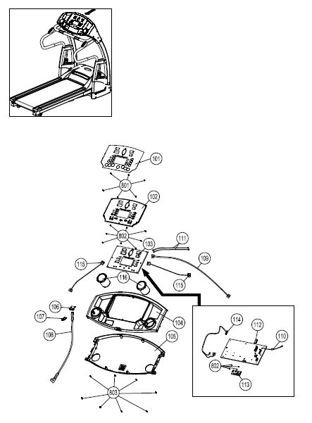

9.35HR Parts List
9.35HR-100 Complete Computer Console
| Item No. |
Description |
Qty. |
Part No. |
| 101 |
Overlay |
1 |
9.35HR-101 |
| 102 |
Computer Insert |
1 |
9.35HR-102 |
| 103 |
Console PC Board |
1 |
9.35HR-103 |
| 104 |
Console Housing ���¢�������� Upper |
1 |
9.35HR-104 |
| 105 |
Console Housing ���¢�������� Bottom |
1 |
9.35HR-105 |
| 106 |
Safety Key Base |
1 |
9.35HR-106 |
| 107 |
Safety Key |
1 |
9.35HR-107 |
| 108 |
Safety Key Wire ���¢�������� Upper |
1 |
9.35HR-108 |
| 109 |
Computer Wire ���¢�������� Upper |
1 |
9.35HR-109 |
| 110 |
Computer Ground Wire |
1 |
9.35HR-110 |
| 111 |
Hand Pulse Wire ���¢�������� Upper |
2 |
9.35HR-111 |
| 112 |
E ���¢�������� Prom |
1 |
9.35HR-112 |
| 113 |
Motion Control Board |
1 |
9.35HR-113 |
| 114 |
Motion Control Board Wire |
1 |
9.35HR-114 |
| 115 |
Motion Control Sensor Wire |
2 |
9.35HR-115 |
| 116 |
Water Bottle Holder |
2 |
9.35HR-116 |

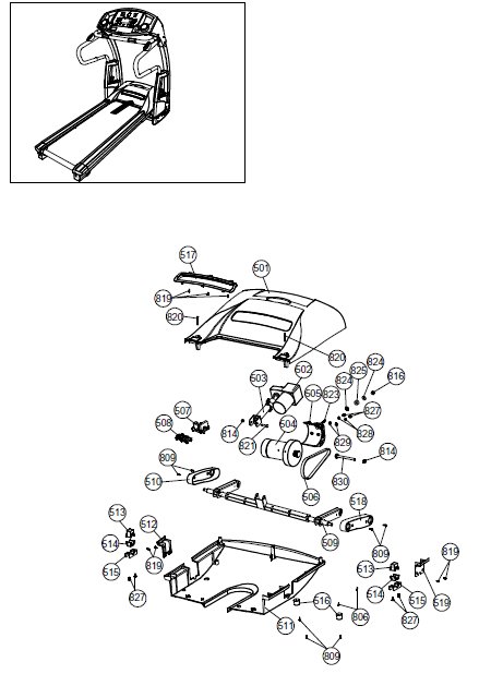

9.35HR-500 Complete Motor Components
| Item No. |
Description |
Qty. |
Part No. |
| 501 |
Motor Hood |
1 |
9.35HR-501 |
| 502 |
Elevation Motor |
1 |
9.35HR-502 |
| 503 |
Elevation Gear Sleeve |
1 |
9.35HR-503 |
| 504 |
Driving Motor |
1 |
9.35HR-504 |
| 505 |
Motor Holder |
1 |
9.35HR-505 |
| 506 |
Driving Belt |
1 |
9.35HR-506 |
| 507 |
Motor Control Board |
1 |
9.35HR-507 |
| 508 |
Elevation Control Board |
1 |
9.35HR-508 |
| 509 |
Elevation Support Tube |
1 |
9.35HR-509 |
| 510 |
Elevation Support Tube Cover - LEFT |
1 |
9.35HR-510 |
| 511 |
Motor Bottom Cover |
1 |
9.35HR-511 |
| 512 |
Deck Frame Side Cover - LEFT |
1 |
9.35HR-512 |
| 513 |
Plastic Clamp - TOP |
2 |
9.35HR-513 |
| 514 |
Plastic Clamp - BOTTOM |
2 |
9.35HR-514 |
| 515 |
Elevation Support |
2 |
9.35HR-515 |
| 516 |
Deck Rubber Cushion |
2 |
9.35HR-516 |
| 517 |
Rear Vent Cover |
1 |
9.35HR-517 |
| 518 |
Elevation Support Tube Cover - RIGHT |
1 |
9.35HR-518 |
| 519 |
Deck Frame Side Cover ���¢�������� RIGHT |
1 |
9.35HR-519 |

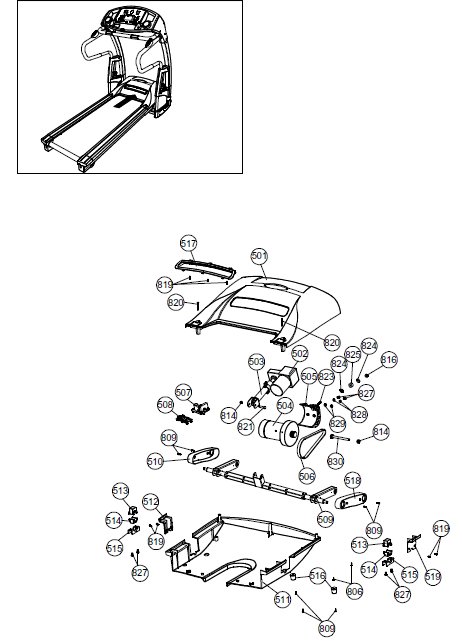

Item
Description
Qty.
Part No.
501
Motor Hood
1
9.35HR-501
502
Elevation Motor
1
9.35HR-502
503
1
9.35HR-503
504
Driving Motor
1
9.35HR-504
505
Motor Holder
1
9.35HR-505
506
Driving Belt
1
9.35HR-506
507
Motor Control Board
1
9.35HR-507
508
1
9.35HR-508
509
1
9.35HR-509
510
1
9.35HR-510
511
Motor Bottom Cover
1
9.35HR-511
512
1
9.35HR-512
513
Plastic Clamp - TOP
1
9.35HR-513
514
1
9.35HR-514
515
Elevation Support
1
9.35HR-515
516
Deck Rubber Cushion
1
9.35HR-516
517
Rear Vent Cover
1
9.35HR-517
518
1
9.35HR-518
519
1
9.35HR-519

9.45ST-500 Complete Motor Components
Item
Description
Qty.
Part No.
501
Motor Hood
1
9.45ST-501
502
Elevation Motor
1
9.45ST-502
503
1
9.45ST-503
504
Driving Motor
1
9.45ST-504
505
Motor Holder
1
9.45ST-505
506
Driving Belt
1
9.45ST-506
507
Motor Control Board
1
9.45ST-507
508
1
9.45ST-508
509
1
9.45ST-509
510
1
9.45ST-510
511
Motor Bottom Cover
1
9.45ST-511
512
1
9.45ST-512
513
Plastic Clamp - TOP
2
9.45ST-513
514
2
9.45ST-514
515
Elevation Support
2
9.45ST-515
516
Deck Rubber Cushion
2
9.45ST-516
517
Rear Vent Cover
1
9.45ST-517
518
1
9.45ST-518
519
1
9.45ST-519

9.45TV-500 Complete Motor Components
| Item No. |
Description |
Qty. |
Part No. |
| 501 |
Motor Hood |
1 |
9.45TV-501 |
| 502 |
Elevation Motor |
1 |
9.45TV-502 |
| 503 |
1 |
9.45TV-503 |
| 504 |
Driving Motor |
1 |
9.45TV-504 |
| 505 |
Motor Holder |
1 |
9.45TV-505 |
| 506 |
Driving Belt |
1 |
9.45TV-506 |
| 507 |
1 |
9.45TV-507 |
| 508 |
1 |
9.45TV-508 |
| 509 |
1 |
9.45TV-509 |
| 510 |
1 |
9.45TV-510 |
| 511 |
1 |
9.45TV-511 |
| 512 |
1 |
9.45TV-512 |
| 513 |
2 |
9.45TV-513 |
| 514 |
2 |
9.45TV-514 |
| 515 |
Elevation Support |
2 |
9.45TV-515 |
| 516 |
2 |
9.45TV-516 |
| 517 |
Rear Vent Cover |
1 |
9.45TV-517 |
| 518 |
1 |
9.45TV-518 |
| 519 |
1 |
9.45TV-519 |

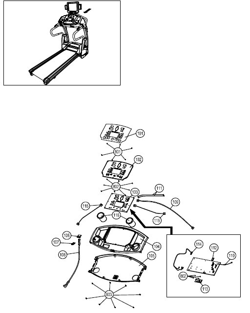

9.45TV-100 Complete Computer Console
Item No.
Description
Qty.
Part No.
102
Computer Insert
1
9.45TV-102
103
Console PC Board
1
9.45TV-103
104
1
9.45TV-104
105
1
9.45TV-105
106
Safety Key Base
1
9.45TV-106
107
Safety Key
1
9.45TV-106
108
1
9.45TV-108
109
1
9.45TV-109
110
1
9.45TV-110
111
2
9.45TV-111
112
E ���¢�������� Prom
2
9.45TV-112
113
2
9.45TV-113
114
1
9.45TV-114
115
1
9.45TV-115
116
Water Bottle Holder
1
9.45TV-116

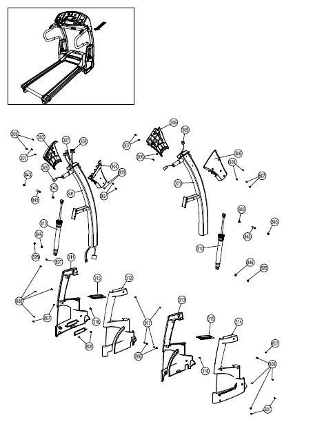

9.45TV-300 Complete Upright Components
Item
Description
Qty.
Part No.
303
Upright Cover-LL
1
9.45TV-303
304
Upright Cover-LR
1
9.45TV-304
305
Upright Cover-RL
1
9.45TV-305
306
Upright Cover-RR
1
9.45TV-306
307
Safety Key Wire ���¢�������� Middle
1
9.45TV-307
308
1
9.45TV-308
309
Motion Control Sensor Wire - Middle
2
9.45TV-309
310
Adjustable Cylinder
2
9.45TV-310
311
Upright Plastic Shroud ���¢�������� LL
1
9.45TV-311
312
Upright Plastic Shroud ���¢�������� LR
1
9.45TV-312
313
Upright Plastic Shroud ���¢�������� RL
1
9.45TV-313
314
Upright Plastic Shroud ���¢�������� RR
1
9.45TV-314
315
Adjustable Cylinder Cover - Upper
2
9.45TV-315
318
Fixing Inserts
2
9.45TV-318

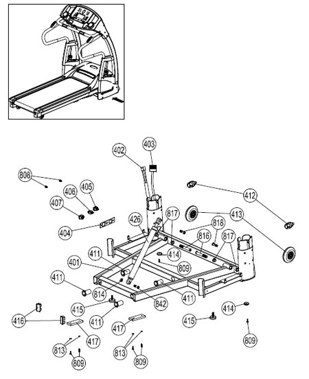

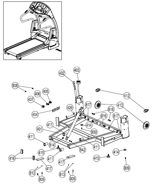

9.45TV-400 Complete Base Frame Components
Item
Description
Qty.
Part No.
401
Base Frame
1
9.45TV-401
402
Safety Key Wire ���¢�������� Lower
1
9.45TV-402
403
Computer Wire ���¢��������Lower
1
9.45TV-403
404
Power Switch Plate Cover
1
9.45TV-404
405
Power Switch Plate
1
9.45TV-405
406
Power Breaker
1
9.45TV-406
407
Power Switch
1
9.45TV-407
412
Fix Bolt Sets
2
9.45TV-412
413
Front Caster
2
9.45TV-413
414
Rubber Cushion
2
9.45TV-414
415
Level Adjuster
2
9.45TV-415
416
Base Frame End Cap
2
9.45TV-416
425
I/O Console
1
9.45TV-425

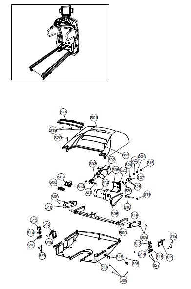

Item
Description
Qty.
Part No.
501
Motor Hood
1
9.45TV-501
502
Elevation Motor
1
9.45TV-502
503
1
9.45TV-503
504
Driving Motor
1
9.45TV-504
505
Motor Holder
1
9.45TV-505
506
Driving Belt
1
9.45TV-506
507
Motor Control Board
1
9.45TV-507
508
1
9.45TV-508
509
1
9.45TV-509
510
1
9.45TV-510
511
Motor Bottom Cover
1
9.45TV-511
512
1
9.45TV-512
513
Plastic Clamp - TOP
2
9.45TV-513
514
2
9.45TV-514
515
Elevation Support
2
9.45TV-515
516
Deck Rubber Cushion
2
9.45TV-516
517
Rear Vent Cover
1
9.45TV-517
518
1
9.45TV-518
519
1
9.45TV-519

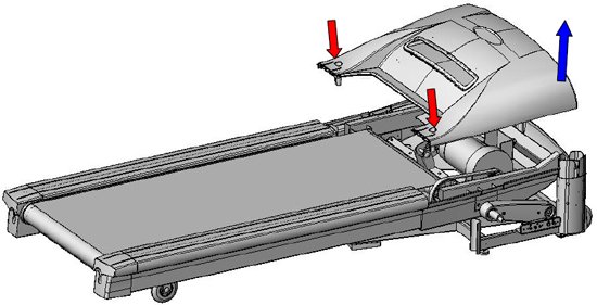

Remove the motor hood
Step 1: Use Phillip screw driver to open 3 bolts and left, right side on bottom motor hood.
Step 2: Use Phillip screw driver to open near both side rails 2 bolts on top motor hood, then move up the motor hood.

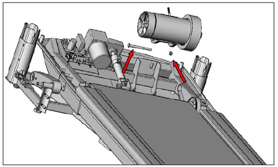

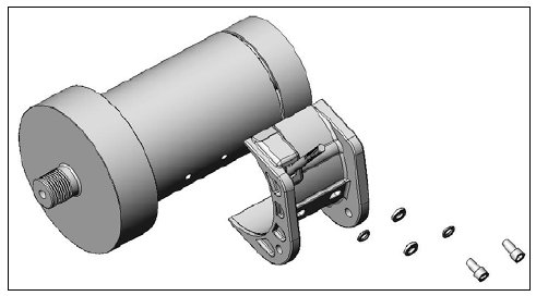

Remove the drive motor
Step 1: Follow remove the motor instruction to remove the motor hood.
Step 2: Use 17mm wrench to open bracket tension nut and remove spacer and PU spacer or tension spring. Then remove the motor belt from motor fly wheel.
Step 3: Use 2pcs 17mm wrench to open bracket shaft and nut from main frame.
Step 4: Then use 5mm Allen wrench to open 2 bolts and bracket from motor..

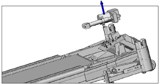

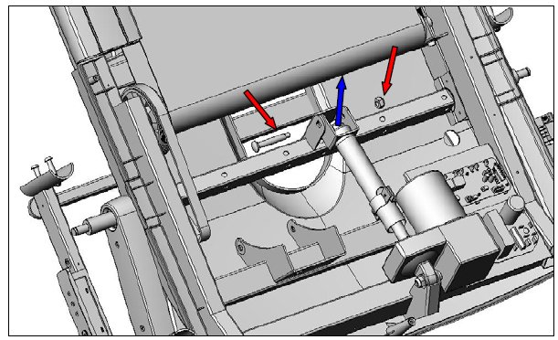

Remove the elevation motor
Step 2: Use 17mm wrench to open the nut and remove bolt, and lift up elevation motor nut.
Step 3: Use 17mm wrench and 6mm Allen wrench to open the nut and bolt from main frame front.
Step 4: Then remove elevation motor set.

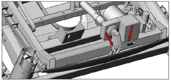

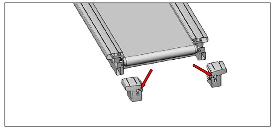

Remove side rail
Step 2: Use Phillip screw driver to open both side end plastic cover.
Step 3: First use 17mm wrench to loose 8 nuts under run desk, then slip out both side rail.

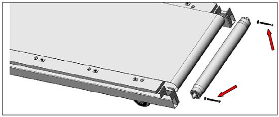

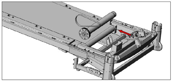

Remove front and rear roller
Step 2: Use 5mm Allen wrench to open front roller bolt from front roller holder at left main frame, then remove front roller.
Step 3: Use 5mm Allen wrench to open rear roller 2 bolts from rear roller holder at rear main frame, then remove rear roller.

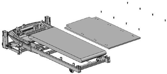

Remove run desk and run belt
Step 2: Follow remove side rail instruction to remove both side rail.
Step 3: Use 5mm Allen wrench to open fix run desk 8 bolt then remove run desk and run belt.

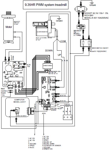

Trouble Shooting
CONSOLE SHOW "Err 2" WHILE TURN POWER ON
The console only one error code and display "Err 2", when replace a new console and switch power on and insert safety key, console will show "Err 2" for 3 sec. then return power status.
If console appear "Err 2", mean must do calibration speed and incline, when finished both calibration procedure, "Err 2" will disappear.
The calibration speed and incline procedure to reference SERVICE SETTING page.
NO DISPLAY REPAIR
NO BELT MOVEMENT REPAIR
ELEVATION MALFUNCTION

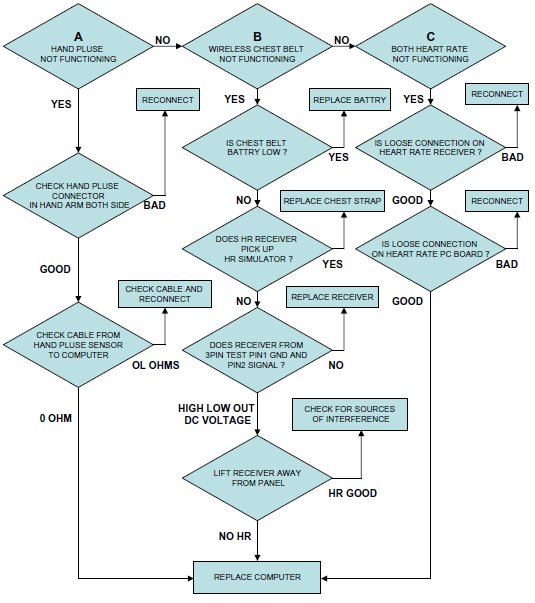

HEART RATE(HR) NOT FUNCTIONING/ ERRATIC READING
MOTION CONTROL (MC) MALFUNCTION FOR

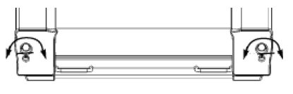

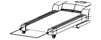

Running belt not at central:
The running belt has been properly adjusted at the factory. However transportation, uneven flooring or other unpredicted reasons could cause the belt to shift off center resulting in the belt rubbing with the plastic side rail or end caps and possibly causing damage. To adjust the belt back to it's proper position please follow the directions below:
1.If your belt tends to walk to the right, rotate the right tension bolt clockwise. We recommend adjustments of 1/4 turn at a time, and follow with a test. If your belt continues to walk to the right, simply adjust the left belt tension bolt by turning it �������¼ turn counterclockwise, and follow with a test.
2.If your belt tends to walk to the left, rotate the left tension bolt clockwise 1/4 turn at a time, and follow with a test. If the belt continues to walk to the left, simply adjust the right tension bolt counterclockwise.
3.If your belt appears to be loose, simply tighten both bolts evenly 1/4 turn. If it appears tight, simply loosen both bolts evenly 1/4 turn.
